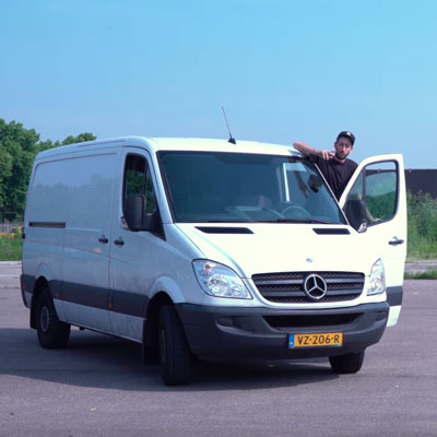

![]() | New & Efficient Save fuel | - Comfortable - Less noise - Easier to find - Less fuel usage | - Support consumption - Harder to repair |

New & Efficient: If you plan to still drive a lot with the van it makes more sense to buy a more efficient newer model or even electric if available. This saves a lot of fossil fuels being burned on a regular basis.

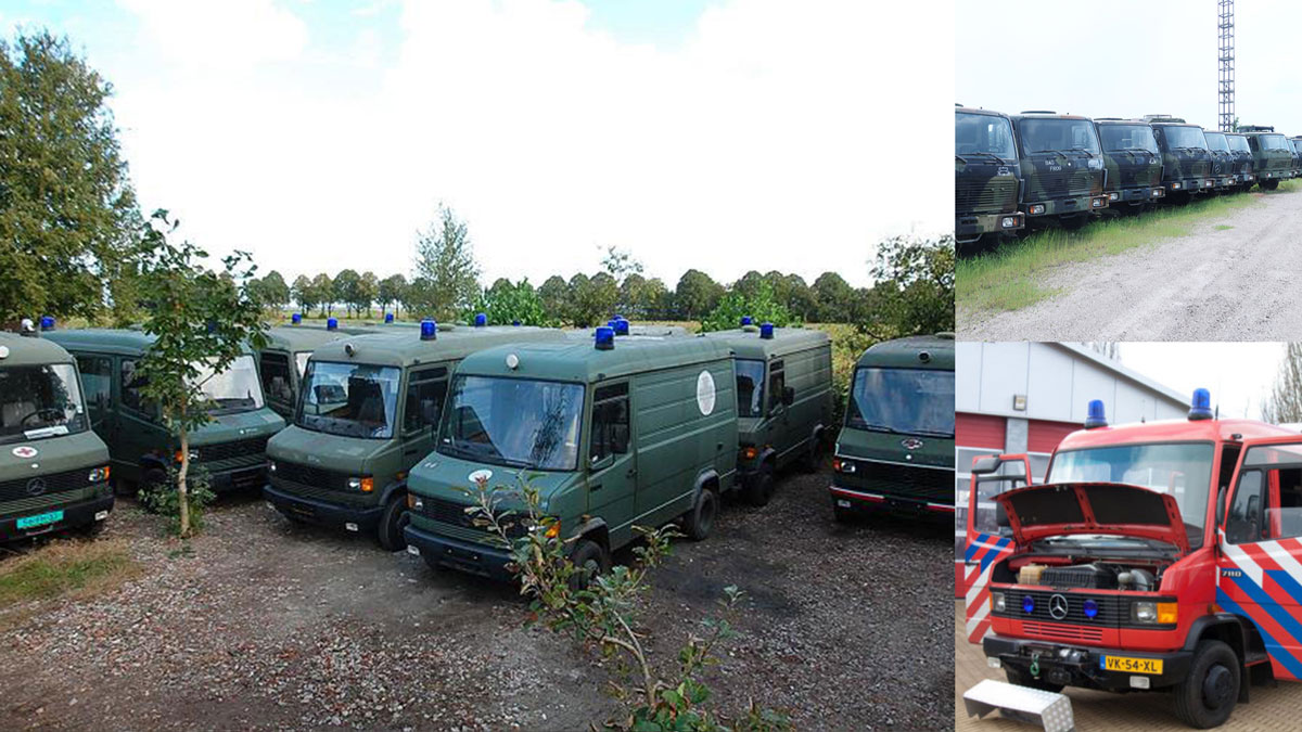

Find a (service) Van
It's not hard to find a van, you can find them at your local dealer or on the internet. However one source worth mentioning is old Government service trucks. From the army, police, fire department etc. They usually have driven very little kilometres, spend most of their time inside and have very good maintenance. And governments tend to pick car brands which are durable (saves them effort on maintenance). So they use models which are common or that have a lot of spare parts available. So they are easier to repair and maintain. They are not always easy to find, but are worth giving them a try.

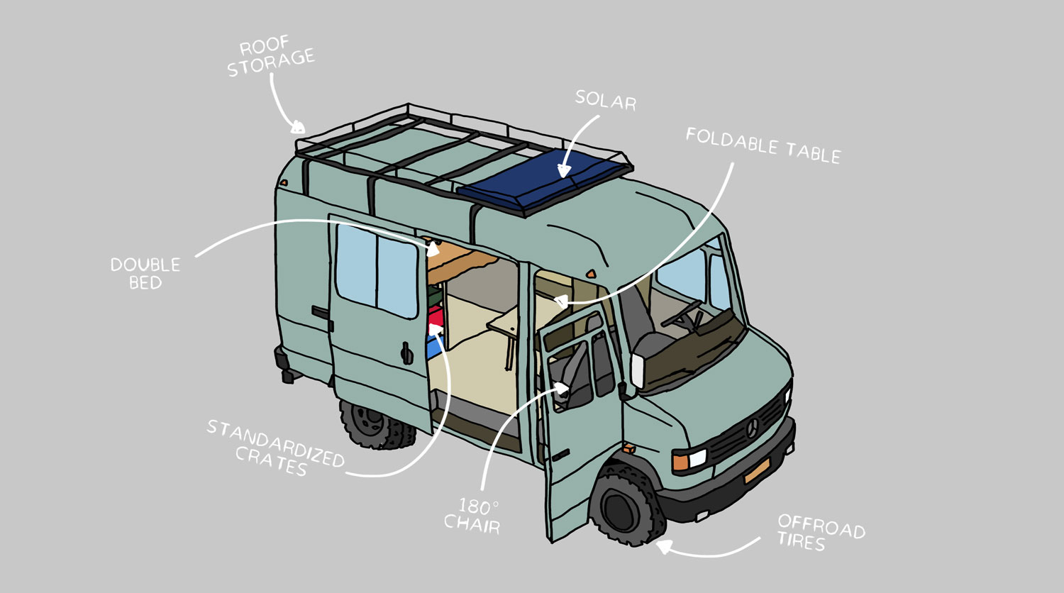

Turn it into a home
This is the fun part, turning your van into a little house. There are many different ways to do this, many videos and instagram accounts. We won't go too much in depth here but advise to just browse around on the web #vanlife. So many clever simple, smart solutions to make your life more efficient and comfortable. But it is also easy to get lost in this, thinking you need it all. We advise to start living in there fast, camp out a few weekends in your parking space. See what works for you and what you care about before you end up building a lot of things you don't really need.
⭐️ Tip: It's easy to get lost in what you think you need. Best is to start living in it and adapt as you go.

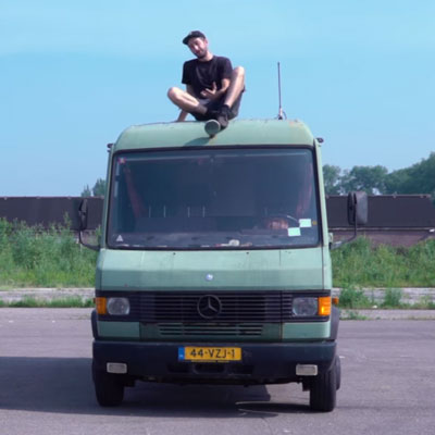

- Most cars are running on 12 Volts, however bigger vans or trucks run on 24 Volts. For instance this army van is 24 Volts.

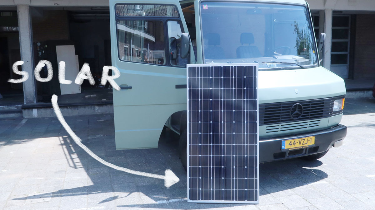

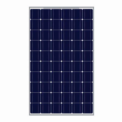

![]() | Solar Panel 210 Wp 1580x808×35mm | The solar panel is mounted on the roof. It provides a 44,36V open clamping voltage. In order to regulate the output of a panel and not kill your battery you need a controller. |

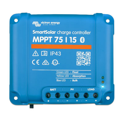

![]() | Charge Controller MPPT 75/15 14/24V | A charge controller gathers energy from your solar panel. They come in many shapes and sizes. Higher quality means you maximise your energy-harvest and extend your battery life. |

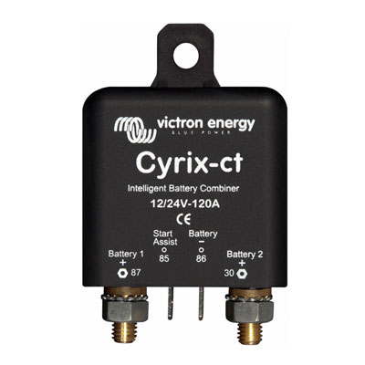

![]() | Intelligent relais Cyrix-ct 12/24V-120A | This relais makes sure your alternator charges your car battery first, then the household. And it prevents the household battery to take power from the car battery. |

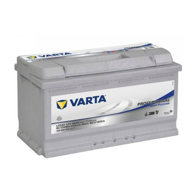

![]() | Battery 12V 90Ah 2 x in series | These batteries are specifically for caravans/campers. Having a minimal self-discharge and work well in low energy demands. |

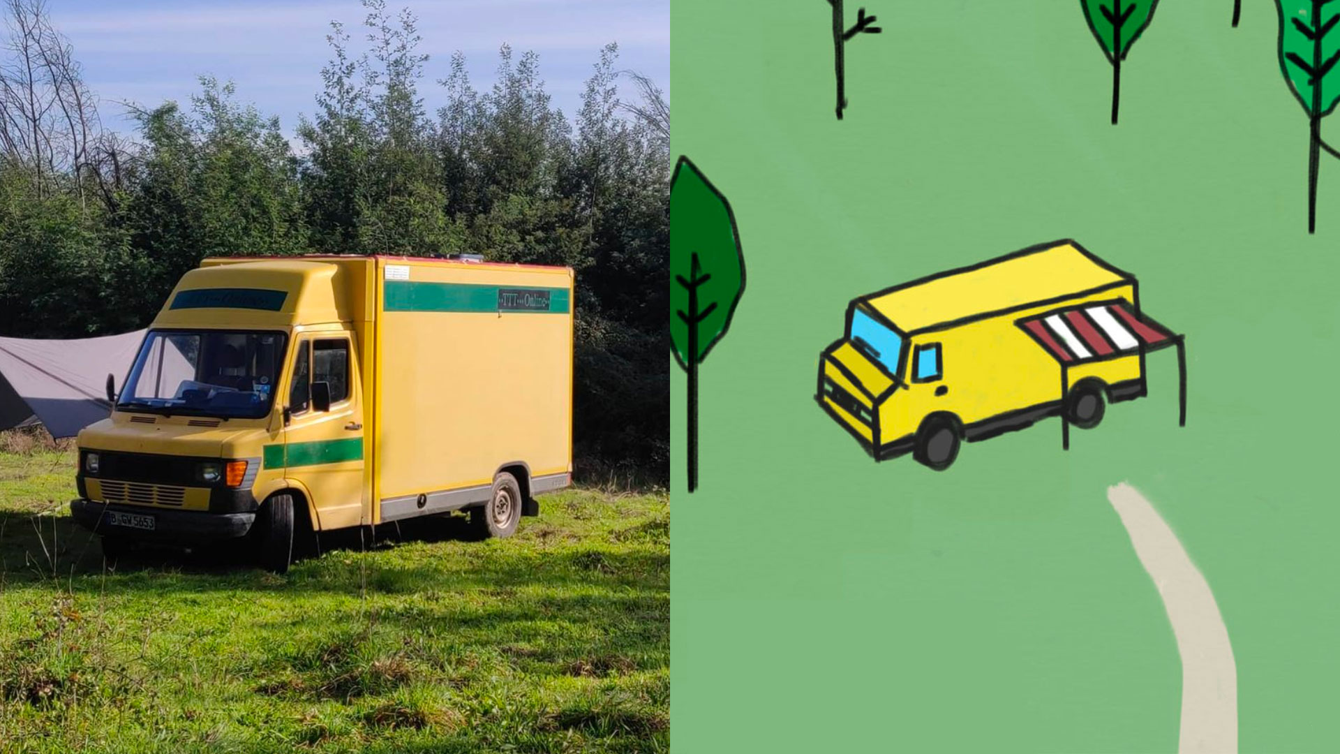

Have a look at Mattia's van featured in Update video #5. It's an old German Post office Van. In the update he gives a tour, explains his best features and problems he had with it. Fun fact, his van is also in the original Project Kamp Drawing :)
